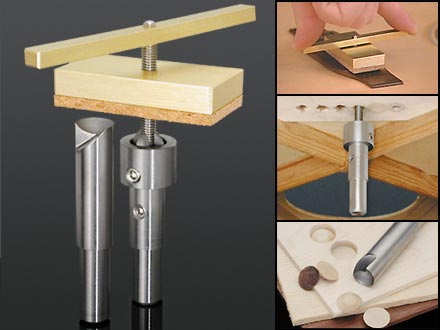

PostPosted: Tue Sep 13, 2005 7:14 am
I like the new tool by StewMac, which allows you to repair the bridge patch with tapered plugs. Then you can just cut round plugs of spruce and bridge patch material and you're back at it again.
Just remember, measure once, cut twice. Or was that....?
Don Williams38609.3131481481
PostPosted: Tue Sep 13, 2005 2:21 pm
this is the bridge saver from Stew-mac Don was talking about.
Bridge saver
